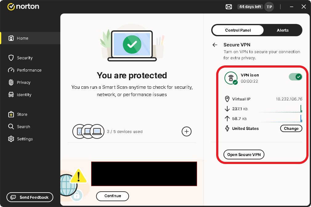

Have you tried the selection P2P optimized region? I’m using that setting as we chat here without any issues. Have you ensured live updates ran at least once manually and a system restart?
Edited: Selecting Fastest I still have a live connection as well.
Using P2P seemed to work, but that shouldn’t be a requirment to have a functioning VPN. It’s kind of like going in to Starbucks and ordering a frappucino and then being handed a hot coffee and told that’s what you get, too bad if it’s not what you ordered.
I agree 100%. Unfortunately, that is what Norton has handed to us with these releases. It is also the very reason we have these pinned threads for them to review. Until they decide that, we, the users, are smart enough to know what works best in our individual environment, we must use work around solutions. Although a VPN is included with N360 its far inferior to the selections available in the stand alone VPN. And its not suggested having both installed at the same because of the conflicts one will have over the other. Some choices right?

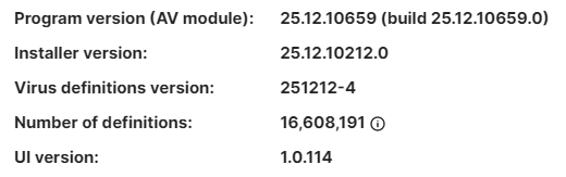

My latest shows as shown below: Manually run live updates again and recheck for the change in definitions.
Thank You SA…..it has now updated and showing the same # of Def as you show. Was weird that it updated days ago but was showing 0 # of definitions. All good now.
Ahhh good news indeed. Good old fashioned manual actions always get results don’t they? lol.

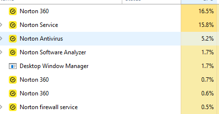

Using up the last of my replies on this thread…
This symptom is always accompanied by high cpu from Norton processes (see below).
As stated above, this version has improved matters - the PC doesn’t become completely unusable and Norton no longer seems to be actually stealing the focus, as confirmed by a focus logger app. When working in a focussed window, other than the high cpu, everything seems ok.
But if you hover over another window, you get a flashing ‘wheel of death’ cursor and can get odd flashing effects with the app that you’re hovering over (noticed with Excel). As soon as the Norton360 app is opened from the system tray, cpu drops back to normal and the flashing cursor largely goes away.

I’m taking a long shot with your CPU specs and the fact it supports ECC dual-channel memory and it doesn’t have on chip video support so you are obviously using an addon video card as well. Are you in fact using ECC memory in this system and what is your GPU ? The notion occurred to me that ECC memory may be giving Norton a hard time because of the way it functions. Does anything in your system event viewer show that is related to memory errors? Your screenshot doesn’t show anything that looks out of the ordinary for Norton running in the task manager either.

My screenshot showed nearly 50% utilization for Norton - if that’s not unusual then it’s definitely getting uninstalled!
But the key thing is that CPU utilisation drops dramatically and the cursor problem disappears as soon as Norton is open on the desktop rather than just in the system tray.
